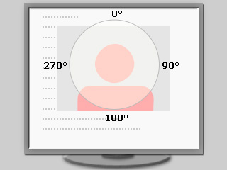

Using the actorGaze Function
Degree(0~360):
Radius(0~100):

player.actorGaze({...}):
degree: This value determines the
direction for the actor to gaze in degrees.

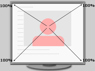

radius: This value determines the
distance for the actor to gaze in percentage.
