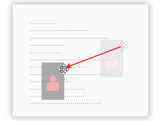

This sample contains a player, and its behavior is:
Drag the eight controls on four sides and corners of the player to
resize it.
Drag the border lines of the player to relocate it.
