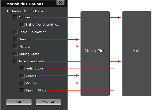

To sum up, the motion data flow from iClone to FBX can be shown in the illustration below:
(Please note that the character's voice is includable in MotionPlus but will be removed when being exported
into FBX)
