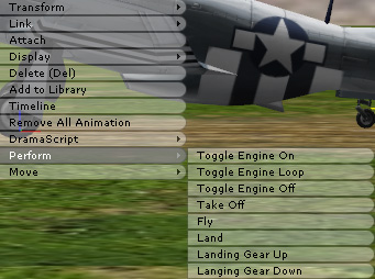

| Editor Mode |

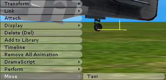

Right click on the plane, and the menu below will appear: |
| Perform |
| Move |

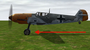

| Move: |
After Move is chosen, choose the destination, and the plane will move there and stay there. You can also press the Space key (stop) to stop recording, and the plane will stop immediately.

| Perform |
| Animation |
Hotkey |
| Toggle Engine On |
1 |
| Toggle Engine Loop |
2 |
| Toggle Engine Off |
3 |
| Take Off |
4 |
| Fly |
5 |
| Land |
6 |
| Landing Gear Up |
7 |
| Landing Gear Down |
8 |

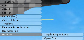

| Editor Mode |
| Perform |

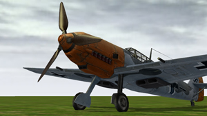

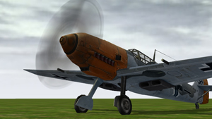

| Toggle Engine Loop: |
Keep the propeller rotating
(Without start or stop) |

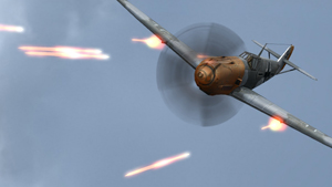

| Open Fire : The plane will open fir |

| Open Fire |
2 |
