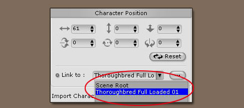

Double click on character so
he is selected.
2. |

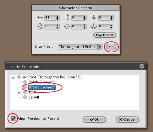

Choose Link
to: Thoroughbred Full Loaded 01 in the character
position module under character tab. |
3. |
Click
open Link to Sub-Node menu. Choose Human Placement and
check Align Position to Parent . |

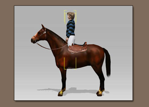

4. |
After the OK button
is pressed, character will stand on the ridding position
of the horse because feet are the base point for iClone characters. |

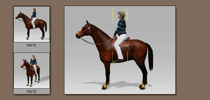

5. |
The character will be positioned correctly on the horse after ridding motion
is applied. If you are using different body type other than Jack, you will have
to adjust the character's position to match with the saddle.

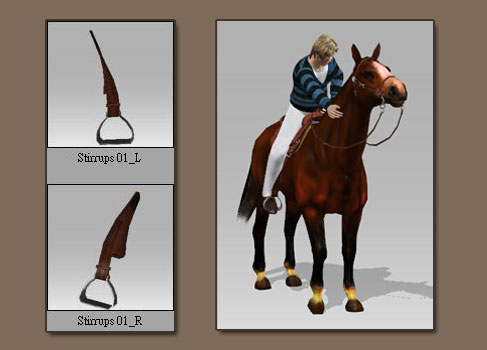

6. |
Equip the Stirrups
Accessories to the character's feet. |
