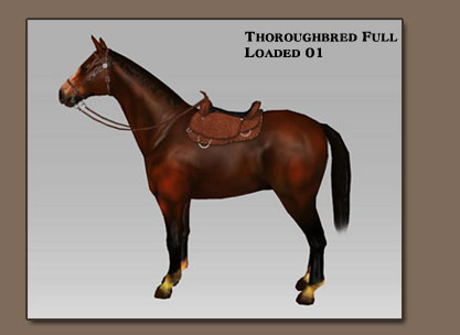

1.
Apply horse live prop from Scene > Props > Template >
The horses are made as 3D live props, iClone 3D Live Props contain 3D props with embedded animation segments. It is usually used to contain multiple loopable animation clips to represent the multiple movements of a living creature. The behavior of Live Props can be set in the timeline by right clicking and selecting target animation clips, eg. a horse can walk, canter, gallop, pesade, etc.

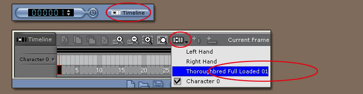

2. Open the Timeline menu. Under Track list , choose Thoroughbred Full Loaded 01

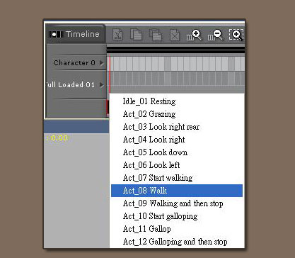

3.
Right click on the time line of the Thoroughbred Full Loaded 01 and the horse's motion list will appear. You can use the motion after you select it. Each motion is able to interconnect to each other.
For example, “Start walking” to “Walking and then stop”.

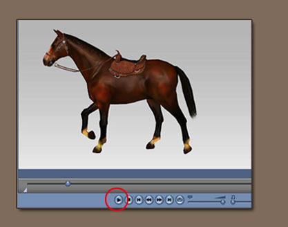

4.
You can see the motion after it has been played.
