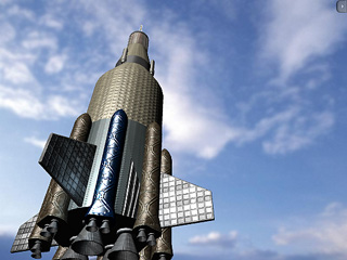

The material library in iClone provides multiple texture channels and seamless tiling capability with which it can easily turn low polygon 3D models into highly detailed 3D props.

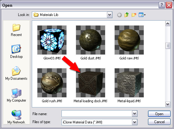

iClone provides a material library in which templates with texture settings are optimized and ready for use. The extension of material templates is .iMtl. (You may find them in C:\Program Files\Reallusion\iClone 4\Template\iClone Template\Materials Lib)
Click the
Explore button to open the folder in which your current materials are located.

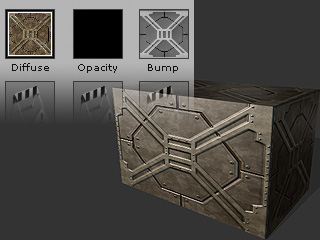

Switch the display mode to view thumbnail images for material templates. Click Open to apply the selected material template

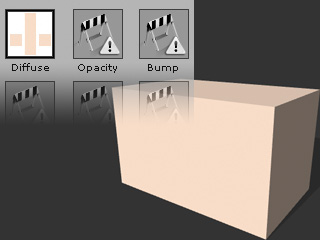

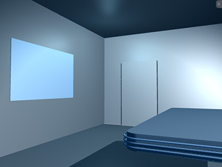

Simple model with single material ID. |
Material template applied. |

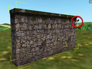

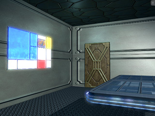

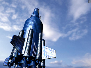

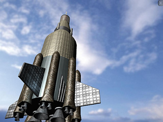

Compound model with multiple material IDs. |
Various material templates applied to |

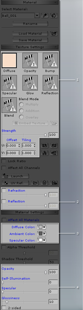

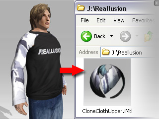

Once you save modified material settings as a new material template, they can be used repetitively afterwards.
Select the object and then use the Pick tool to pick the material from which you want to save the texture settings as material template.
Click Save Material button.
Browse to the destination folder to store the template. If you select an existing material file, it will be replaced by the new one.

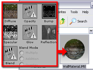

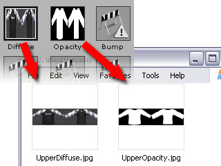

1. |
The texture maps for the seven channels. Please refer to the Adjusting Colors on Seven Texture Channels and Texture Channel UV Offset and Tiling sections for more information. The Strength value of each channel. |
2. |
The values of Reflection and Refraction are saved. Please refer to the Modifying Texture Settings - Advanced section for more information. |
3. |
The Diffuse, Ambient, Specular colors are saved. Please refer to the Modifying Texture Settings - Advanced section for more information. |
4. |
The Opacity, Self-Illumination, Specular and the Glossiness values of individual material are saved. Please refer to the Modifying Texture Settings - Advanced section for more information. The 2-sided status is also be saved. |
Tips: |
When an object contains multiple material IDs, it may be a hard task for you to adjust their texture settings individually. IClone provides a feature for you to change them all at the same time.
In the Select Material drop-down list, pick any material to modify.
Modify the parameters: Diffuse Color, Ambient Color, Specular Color,
Opacity, Self-illumination, Specular and Glossiness.
(Please refer to the
section for more information about the effects of these settings.)
Check the Effect All Materials to apply these settings to all the materials on the list.
