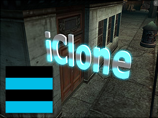

Adjust the Glow map to change the intensity of the glowing effect of your objects.
Saturation = 0 |
Saturation = 100 |
