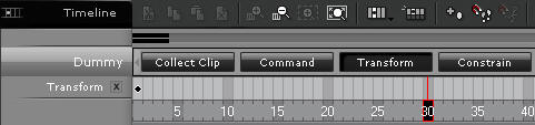

Move the current frame to Frame 30 in the Timeline. Move the segment or Skirt template to generate a moving animation.
Make sure that Preference/Enable Spring/Flex Effect is checked. Play the animation from the very beginning to see the result. |

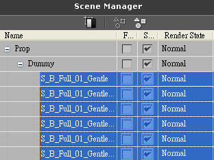

Choose the segment that you want to update from the Scene Manager (Ex. all), and execute Modify/Spring/Import Setting. |
