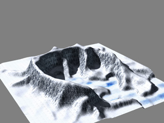

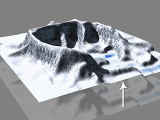

  1. Load a Height Map Terrain template from the Set >> Terrain >> Content Manager >> Height Map Terrain library as a base.
  2. In this case, the Snow Mountain is applied.

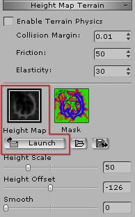

  3. In the Modify panel, scroll to the Height Map Terrain section.
  4. Select the Height Map thumbnail and click the Launch button to open the height map image in your favorite image editor.

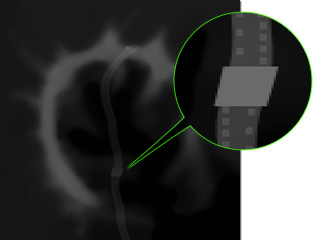

  5. Edit the grayscale image.
    The original height map image.
    White: Peaks
    Black: Valley

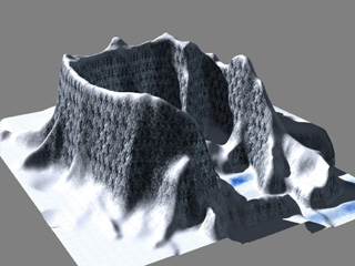

    The height map image after being edited.
  6. Save the image and go back to iClone, the terrain will be updated automatically.

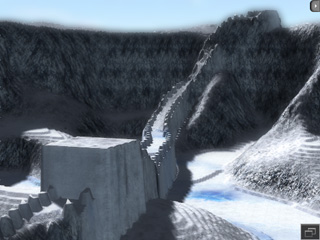

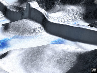

    • Because the size of the terrain is 25600 x 25600 (cm square), while the size of the height map image is only 513 x 513 (pixel square), each pixel in the image thus represents 50 x 50 (cm square) area in iClone, which will cause some creasing.

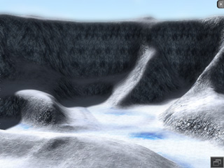

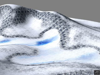

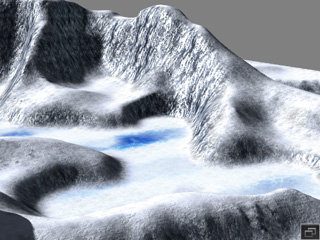

    • In order to solve the crease phenomena, you can increase the smooth value between 1 to 3. However, the sharp edges in this example will look melted or weathered.

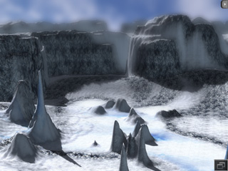

  7. You may also load a prepared image file in grayscale format (if the loaded file is a colorful one, then iClone will automatically convert it to grayscale format first) to create a new terrain with different rises and falls.
    The landform is changed in accordance with the definition of the loaded image.
