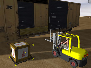

Drag and drop the crate
Scroll to the Linkage section and click Pick Parent button.
Navigate on the 3D viewer and click on the target object. The prop may be still at the wrong position.
Pick the lifter of the forklift as the parent of the crate

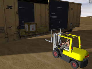

Adjust the position of the prop for better placement if necessary
then click
the
button and check the correct sub-node is selected in the Link to Sub-Node panel, check
the Align Position to Parent box and click OK. The
prop then will be forced to align to its parent.
The crater is aligned to the lifter

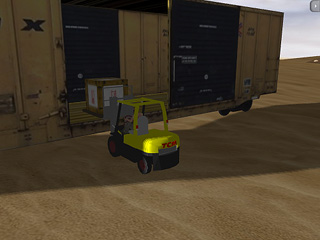

Move the parent object to test the result.

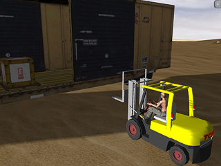

Go to the desired frame when the prop will be linked to another parent.
Go to the frame for changing the linking parent
Click the Pick Parent button again.
Click on the desired parent on the 3D viewer. Now the parent is changed.
The crate is now linked to the train.

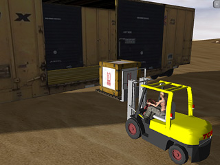

Move the new parent object. The transform data of the prop will now be controlled by the new parent.
The train moves away with the crate
