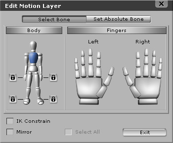

  4. In the Edit Motion Layer panel, pick the upper torso shown in the illustration below.

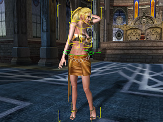

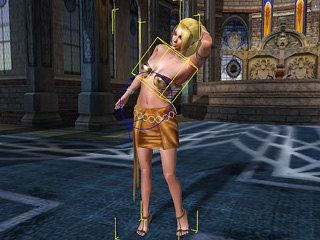

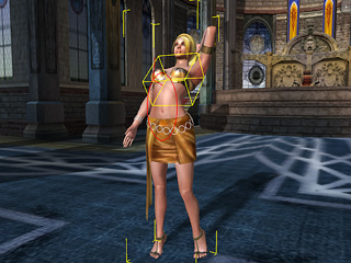

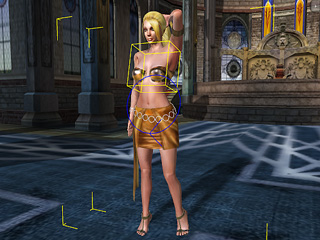

  1. Drag your mouse or roll the mouse wheel on the 3D viewer.
Note:
  • You may toggle among rotation axis by right-clicking in the 3D viewer and then either drag on the 3D viewer or roll the mouse wheel to rotate the selected bone.
  • Right-click to change the axis and drag or roll the wheel to adjust offset position.
