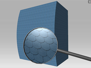

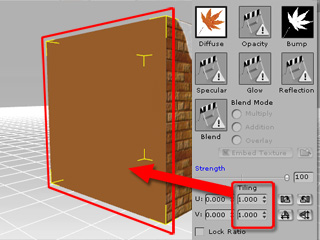

However, if the original model from Google SketchUp has no prior texture assignment (purely with default color material), when you apply texture in iClone, the result may not be what you expected.
In the sample above, the solid blue color is made by massive grainy texture tile on this model (with the default 1x1 UV tiling settings in iClone). If the model in Google SketchUp has no prior texture assigned to it, the default UV tiling value is way too small for further texturing works.

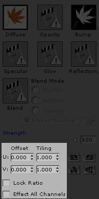

iClone provides Texture Channel UV Offset and Tiling feature to solve this problem. You may then customize the offset and tiling values to each texture channel without changing the original Global UV Setting. You may use this feature to best align a texture map to the target faces as well.

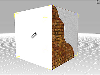

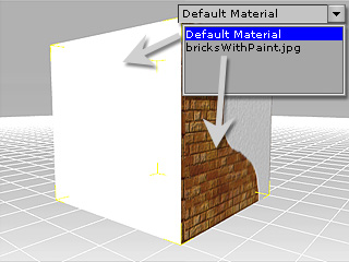

    1. Select a prop (in this case, some faces contain no texture) converted by 3DXchange from SketchUp.
    1. Press the Material Picker and click on the face without any texture to retrieve its material and texture settings.

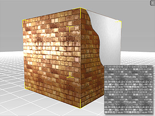

    1. Select the Diffuse channel and click the buttons to load an image as the diffuse texture. The massive grainy texture tile makes it look like a solid color in the illustration below.

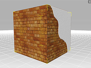

    1. Adjust the Tiling value to make the texture show an appropriate mapping result. In most SketchUp cases, it is a small value such as:
      Tiling U = 0.010
      Tiling V = 0.010
    Adjusting Individual Texture Channels

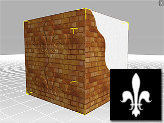

    By means of altering the values of Offset and Tiling to different texture channels, we can create all possible multi-texturing effects on SketchUp models.

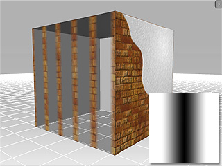

    Opacity
    Bump
    Tiling U: 0.050
    Tiling V: 0.010
    Tiling U: 0.010
    Tiling V: 0.020

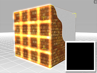

    Glow
    Tiling U: 0.010
    Tiling V: 0.010
    Tiling U: 0.040
    Tiling V: 0.040
