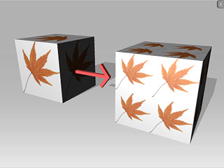

Lock Ratio
Check the Lock Ratio box to simultaneously adjust the U and V values in the latest UV tiling ratio.
Lock Ratio: unchecked.
Adjust Tiling U from 1 to 2.
(Tiling V remains 1)

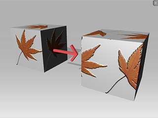

Lock Ratio: checked.
(Tiling V changes to 2 simultaneously)

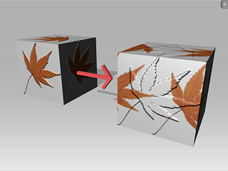

Current Channel: Diffuse.
Effect All Channels: unchecked.
Adjust Offset U from 0 to 0.5.
Only the Diffuse map moves.

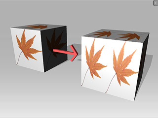

Effect All Channels: checked.
Adjust Tiling U from 0 to 0.5.
Bump map moves simultaneously.
