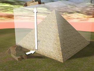

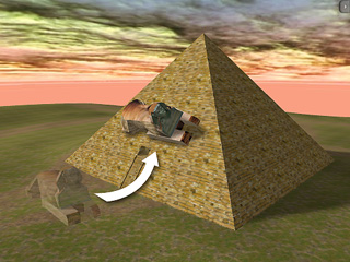

  5. Apply another prop (Sphinx) and drag it across the terrain to see the result.

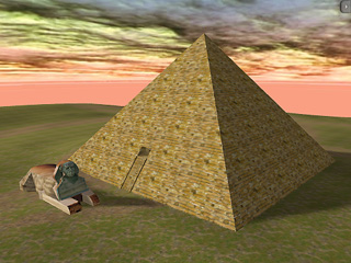

  6. Check the Use Bounding Mesh box. Drag the prop across it again and see the different result.
Use Bounding Mesh = OFF
Use Bounding Mesh = ON

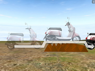

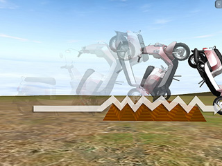

This feature is useful if you want to utilize the Follow Terrain or Snap to Terrain function in iClone . It can prevent your objects from twitching as they are crossing a complicated but small folds of terrain components.
