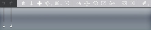

Undo/Redo
1
Undo
To undo the last action made for the current project. The maximum number of actions you can undo can be set in the Preference panel. It is also limited by the amount of space on your hard disk.
2
Redo
To redo the last action.

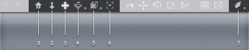

Camera Tools
1
Home
To snap the camera to a 45 degree perspective to the selected object.
2
Zoom
To zoom in and out of the scene.
3
Pan
To pan the camera.
4
Orbit/Roll
To rotate the camera. Click its down arrow to switch to Rotate or Roll mode.
5
Camera View
To switch the camera to different view, click the down arrow and choose from Front, Right, Top, Left, Bottom, Back, Face or All.
6
Center
Click this button so the camera snaps to view the selected object in the current project.
7
Walk/Fly
Switch the camera into Walk or Fly mode. You can then move the camera in game-like fashion by using the W.A.S.D., or other specified keys on your keyboard.
If you want to switch back to the normal camera mode, press ESC key.

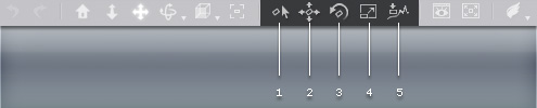

Manipulation Tools
1
Select Object
Toggles the Select mode. You may then directly pick the object in the 3D viewer.

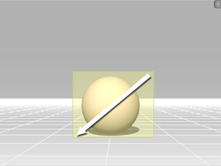

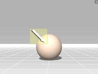

You may also drag a rectangle around multiple objects to select them in this Mode.
Drag from left to right: Any object partially contacting the rectangle will be selected.
Drag from right to left: Only the objects covered entirely within the rectangle will be selected.
2
Move Object
To switch to Move mode. You may then directly move the selected object in the 3D viewer instead of manually entering the values on the Modify page.
Left Mouse Button: Move object along X-/Y-axis.
Mouse Wheel: Move object along Z-axis.
Right Mouse Button: Rotate object on Z-axis.
3
Rotate Object
To switch to Rotate mode. You may then directly rotate the selected object in the 3D viewer instead of manually entering the values on the Modify page.
Left Mouse Button: Rotate on Z axis.
Right Mouse Button: Rotate on X axis.
Both Mouse Buttons: Rotate on Y axis.
4
Scale Object
To switch to Scale mode. You may then directly scale the selected object in the 3D viewer instead of manually entering the values on the Modify page.
Left Mouse Button: Uniformly scale object.
Right Mouse Button: Scale object along Z axis.
Both Mouse Buttons: Scale object along X - Y axis.
In Move Object, Rotate Object or Scale Object modes, you may also:
Alt + Left Mouse Button: To Pan the camera.
Alt + Right Mouse Button: To Rotate the camera.
Alt + Both Mouse Buttons: To Zoom the Camera.
5
Align to Terrain
Click this button so the selected objects will always be moved along the terrain, if present.
If you switch to Snap to Terrain or Follow Terrain modes, movement is constrained to the ground and will follow the contours of the terrain as you move.
You must select Off to cancel the constrain.

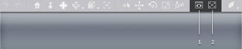

Preview and Full Screen
1
Preview
To render the current view of the 3D viewer into an image. You may then save this image afterwards.
2
Full Screen
To enter full screen mode.
