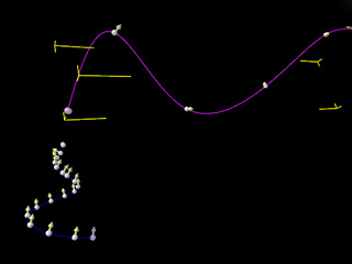

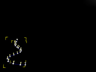

  1. Create your first path.
  1. You may click the Edit Path button to position the Control Points.
  2. Now, create another path in the sky.

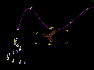

  1. Add a prop into the scene.
  1. Go to the Path section in the Prop's modify panel and click Pick Path .

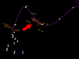

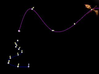

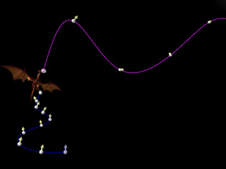

Keying Path to Path
  1. Select the first path's starting point and the prop snaps right onto the target pointer.

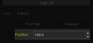

  1. Drag the Timeline Slider to a preferred frame. Adjust the value in the Position field to set the prop's position and add a position key on the selected frame.
  1. Drag to a new frame in the Timeline and click the Pick Path button and select a control point on the second path.

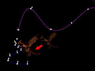

  1. Drag the Timeline Slider to a new frame again. Adjust the value in the Position field and make the prop move to the last control point on the pink path.
  1. The prop moves smoothly between path to path.
