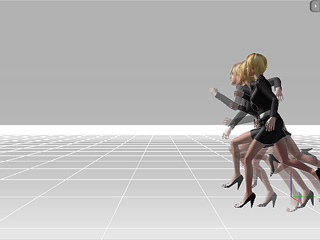

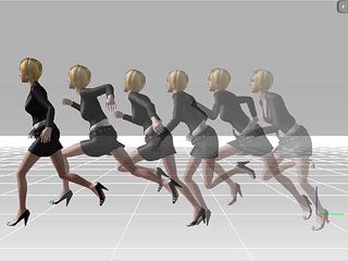

You may notice that sometimes the actor moves away as we apply an animation to it. You may want to modified this motion and make it a custom one to be used later as Perform, Walk, Operate motions. To achieve this goal, it is better to have the whole motion to happen in the same position. You may then utilize this feature to prevent from setting the pose back to the same location manually frame after frame.
Prepare Custom Motion
  1. Pick one actor to apply a motion to.
  2. Open the actor's Motion track. Apply a motion that moves the actor away.
    You may optionally modify the motion via the Motion Layer track.
  3. Select this motion clip in the Motion track. Click the Reset Motion Pivot button. The whole motion then happens at the same position.
  4. Open the Collect Clip track. Drag in the track to mark a range to include all the motion in the Motion track.
  5. Right click in the range and save it to your desired directory.
