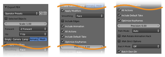

Export Settings in Blender
Using default setting to export:
Highlight class Armature & Mesh, and enable "include Animation" if animation is embedded.
