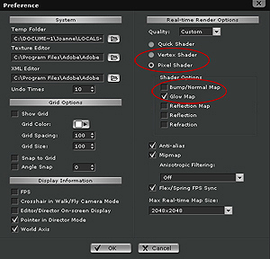

1. Open the Preference Menu |
Make sure that Pixel Shader is selected and GlowMap is checked. |

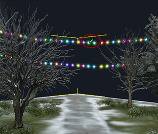

Choose the area that you want it to be flashing |

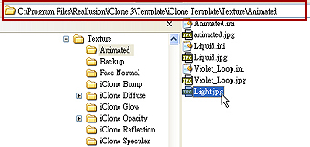

Save the final version file to the location below |
10. |

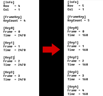

Open Light.ini, and change the parameters to become the same as the picture in the right, and then save it |
12. |

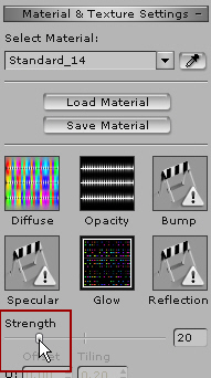

Drag the Strength to the brightness that you need |
2. |

7. Make 5 different styles |
Line them up and save as a new texture Light.jpg |
9. |

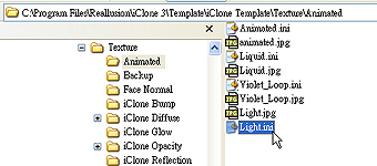

Copy the already existed Animated.ini, and save the file name to Light.ini (Must be the same as the picture file name.) |
11. |

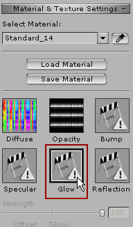

Go back to iClone3, and double click on Glow. Load Light.jpg |
13. Play to see the effect |
14. |
If it's what you want. Add it in Content Manager and it will be saved |
