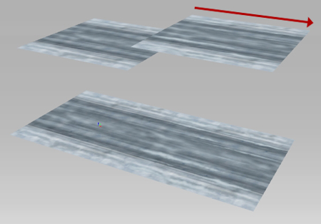

A. Combine floor system
1. Our floor uses 1000 as a base unit. Therefore, you can use the Transform tool to easily link each floor seamlessly without fine-tuning.
2. Combine lots of floor props via Move Transform menu.

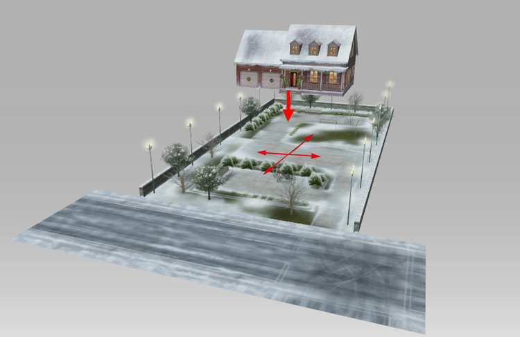

  B. Import main buildings
Import main buildings and move to where you want to place on.

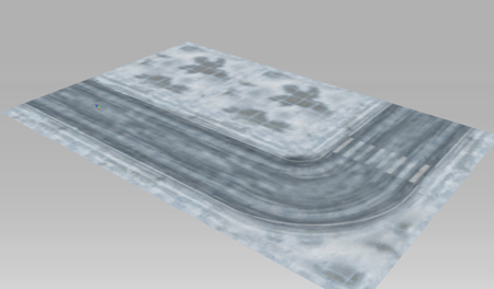

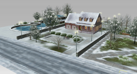

  C. Adorn your city
Import floor, panorama, hedge, stone wall, trees, park, pool, cars to arrange your street block.

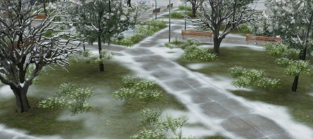

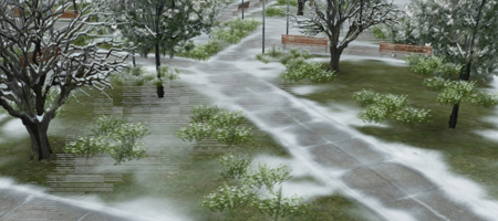

  Hint: When 2 floors are on the same plane, the render engine may cause some rendering errors. You could adjust vertical value to solve it.

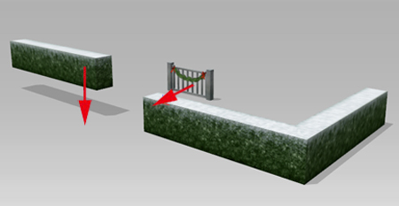

  D. Attach props
When there are many props in a scene, we sometimes need to attach props.
1. Arrange the props to the position that you want them to be.
  2. Choose a prop, and click the Pick Parent button.

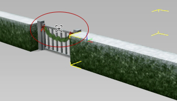

  3. After the Pick Parent button is clicked, the mouse cursor will change (as the picture below). Click another prop.
  You can see the result in the Scene Manager (as the picture below).
