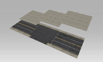

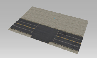

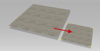

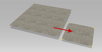

Much like assembling a puzzle, place the ground planes together to manipulate it as one unit. |
1. |
Our ground planes use 2000 as a base unit. Therefore, you can use the Transform tool to easily link each floor seamlessly without fine-tuning. |
2. |
Place the ground planes via the Move Transform menu, arrange in many different combinations in order to create a customized terrain. |

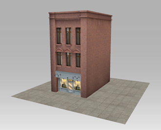

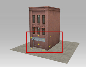

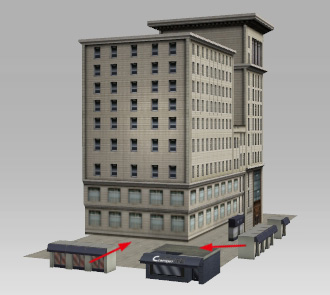

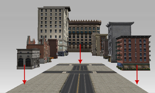

B. Attachable Building Block System |
Import various buildings and position them as you like. |
![](images/Br.jpg) |

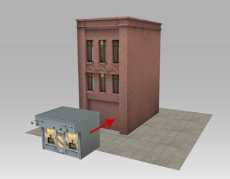

Hint |
When combining Building, part of the shop may be covered by building walls. You can make Opacity textures for the building to solve this problem. |
Make a Opacity texture (The black area will not be displayed), and load Opacity Channel. |
The shop will no longer be covered. |

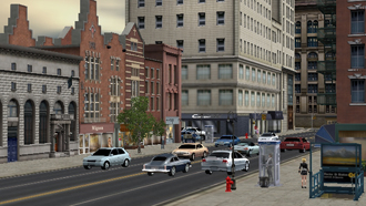

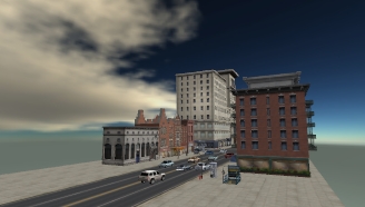

C. Adorn your city |
Import floors, buildings, street lamps, phone booths and cars to arrange your street block. |

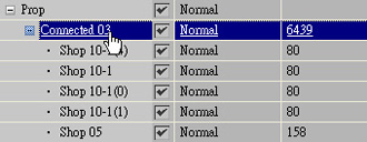

Choose a prop, and click the Pick Parent button. |
3. |
After the Pick Parent button is clicked, the mouse cursor will change (as the picture below). Click another prop (e.g.Connected 03). |
4. |
The Shop is now attached to Connected 03. Any transformations to Connected 03 will also be made to the Shop. (Note: The Hierarchy for attaching is limited to one level only.) |
