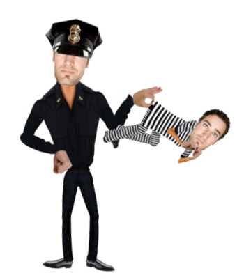

B. Adjust the aspect ratio of body parts. |
B-1 |
Select the body parts and drag it to adjust aspect ratio as below. |
a. You can scale it proportionally, when the cursor is on the corner of the active object. |
b. You can scale the width when the cursor is on the side border of the active object. |
c. You can scale the length when the cursor is on the top or bottom border of the active object. |
Tip. You can also type in value in Transform Editing. |
B-2 |
It's done! |
