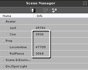

A project with 3D objects |
The face count for each minor object |

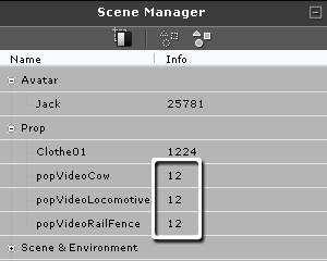

Convert all minor objects into popVideo and then load them back into your project to replace the original 3D objects. Doing this will decrease the project size and reduce your system-resource loading.
3D objects replaced with popVideos |
The face count for each popVideo |

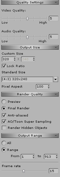

The export popVideo area is split into 4 sections: Quality Settings, Output Size, Render Quality, and Output Range.
Quality Settings
Use the sliders to define the Video and Audio quality.
Output size
You can define the size of the exported image in the Output Size field. To define output size:
Select either a Standard Size or define a Custom Size using the arrow icons.
Please note that if you activate the Lock Ratio box, you can only adjust the width of the project while the height is updated automatically in current ration.
Render quality
The render quality can be set to Preview or Final Render using the radio buttons. Check the Anti-Aliased checkbox to export an anti-aliased image. An anti-aliased output will produce an image with less jagged edges and pixelated areas. You may also enable the Render Hidden Objects option in case some objects were hidden during the editing process.
Output range
You can either export the entire video, or a specific range of frames. Select the output range using the radio buttons in the Output Range field. You can also set the Frame Rate here using the slider. The output range can also be set using the 2 triangle markers below the play bar.
