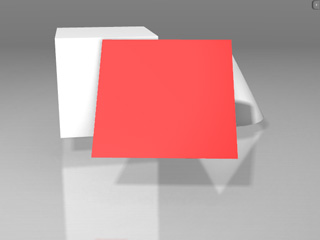

Select a prop or an accessory. You are allowed to select multiple objects to assign the same physics setting at the same time.
Closed object
Singular surface

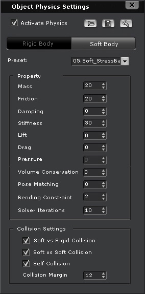

Activate physics by clicking the Physics Settings (Shortcut: Shift + F9). Enable the Active Physics and press down on the Soft Body tab.
You may use the Preset drop-down list to apply a soft-body preset instead of setting individual values.
Please refer to the links below for more information about the parameters in the Physics Object Settings panel.

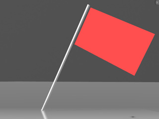

Soft Bodies Only
Soft Body Simulation - Off:
The physics animations can not be seen in the preview window.
CPU loadings are light.
Soft Body Simulation must be switched ON
before exporting.

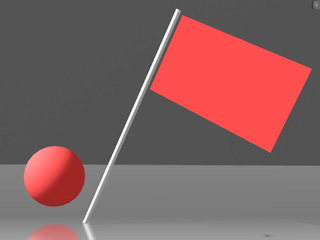

Soft Bodies and Rigid Bodies
(No collision between them)

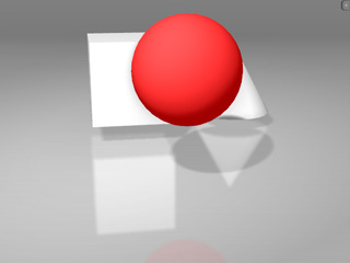

(Colliding with each other)
Soft and Rigid Body Simulation - On:
Turn on the Soft and Rigid Body Simulation to ensure collision.
The collision effects of the Rigid Bodies can be recorded into their Animation track.
CPU loadings are heavier.
