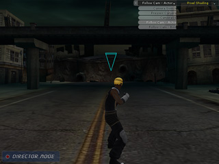

The Follow Cam - Actor Mode |

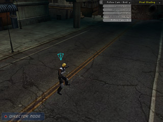

The Follow Cam - Bird Mode |
