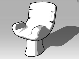

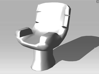

Toon Shader with no texture |

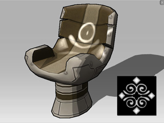

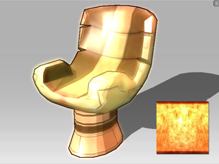

Toon Shader with Diffuse Map |

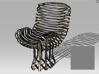

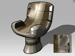

Toon Shader with Opacity Map |

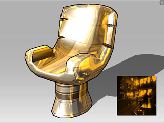

Toon Shader with Reflection Map |

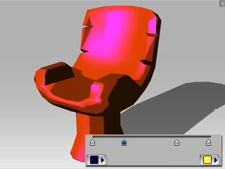

The Toon Shader covers three levels of colors onto all objects, and once the colors are set, the Diffuse, Ambient and Specular colors of objects will be blended with the three-level gradient colors.
You may drag the middle-second anchor to adjust the range of each level.

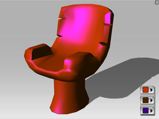

Original color |
Adjusted Diffuse, Ambient and Specular |
