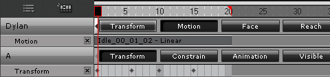

Open a project with animations in different objects. Start from the
first frame.
Open the Timeline (F3).
Click the Track List button and select Project to show the project track.
Press down the Project button. Click the first
frame on the track.

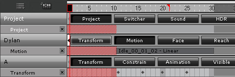

Click the
Insert Frames button on the tool bar. Enter a frame number
before the start frame.
Click the OK button and the specified number of frames will be added before the start frame.
The initial animations will then be postponed and the total length of the project will be increased.
