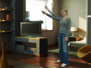

Real human motion.
Only the right hand receives the motion data.

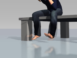

Real human motion.
The feet receive the motion data.
