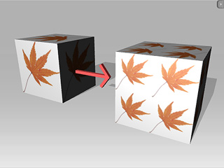

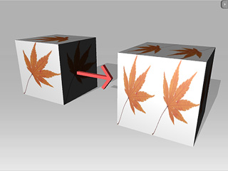

Check the Lock Ratio box to simultaneously adjust the U and V values in the latest UV tiling ratio.
Lock Ratio: unchecked.

Lock Ratio: checked.
Adjust Tiling U from 1 to 2. |

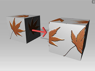

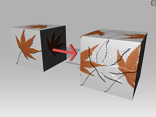

With this option checked, any change of UV offset or tiling value also applies to other texture channels - Diffuse, Bump, Opacity, Specular, Glow, while the reflection map remains unchanged. We will take Diffuse and Bump maps as an example.
Current Channel: Diffuse. Effect All Channels: unchecked. Adjust Offset U from 0 to 0.5. Only the Diffuse map moves. |
Current Channel: Diffuse. Effect All Channels: checked. Adjust Tiling U from 0 to 0.5. Bump map moves simultaneously. |
