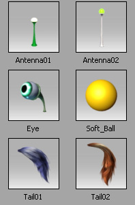

iClone provides Spring Props to simulate the dynamic behavior of bouncing objects. This type of flexible props can spring back and forth by its own momentum, or affected by the movement from the parent object it is attached to.
Click the thumbnails below to view demo videos. You may also refer to the Bouncing Body Parts section for more information about the spring effects on human body parts.
Please go to Set/Props/Template/Props/Spring folder to choose any of the spring prop templates.
