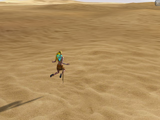

In the Director Mode, you may command your actors or props to Perform via the Right-click Menu or Hotkeys during the recording process. Once the performing process is done, the motion during the recording will be stored right onto the Perform track.

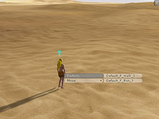

Alternatively, you may right-click on the 3D viewer to pop up the Right-click Menu. Select any sub-command in the Perform entry.
The motion/animation clip will be stored into the Perform track instantly as the perform process finishes.

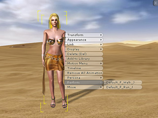

In the Editor Mode, you may also add motion/animation clips into the Perform track. However, you can only achieve this goal by using the Right-click Menu.
In the Editor Mode, right click on the actor/iProp perform actions.
The motion/animation clip will be stored into the Perform track instantly.
