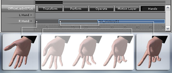

Hands Track
Toggling the Hands button on the timeline will show two tracks. One is for storing the motion of the Left hand and the other is for the Right hand. Refer to the Speed, Loop and Blending section for more information about the interactions between clips.

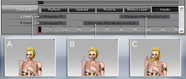

  1. Pick an actor and go to the desired frame for changing hand motions.
  2. Go to the Animation/Hands/Modify page, scroll to the Gesture Library section.
  3. Select one of the three radio buttons (Left, Right or Both) in accordance with the hand/s you want to add motions to.
  4. Click the drop-down list to select a template. The motion will be added instantly.
A: Apply to Both Hands
B: Right Hand Only
C: Left Hand Only

  • The blending effect between two hand motion clips will be generated automatically.
