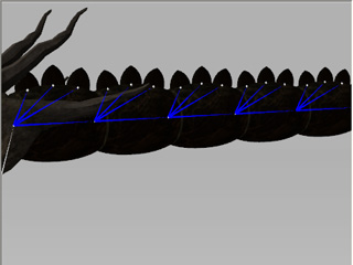

  3. Select one or more bones to which you want to apply spring effects.
  4. Click the Active Spring button.

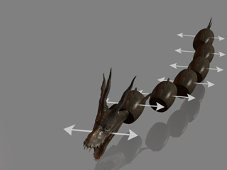

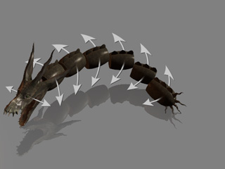

Translate and Rotate
The spring type can be set to Translate or Rotate, which determines the bouncing manner for the nodes. Please note that the result will be unexpected if you apply a mixture of Translate and Rotate values to different nodes in a group.

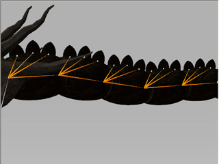

Soft and Hard
The softness of the spring effect can be applied to individual elements in a spring group (please refer to the next section for more information about the Spring Group), which determines the looseness of the nodes when they bounce.
Soft and Hard
Since the Soft / Hard slider determines the values of any element in a group, it is recommended that you set the nodes that are away from the root node with a harder value while the ones closer to the root with a softer one. This can ensure the spring chain naturally trembles without too much jittering.
Softest
Hardest
