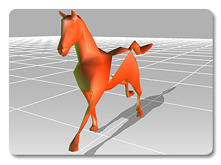

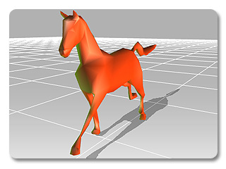

  1. Select the mesh nodes that have holes on the surface.
  2. Click the Unify button.
Before Unifying
After Unifying
