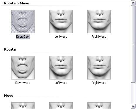

  3. Click on one of the thumbnails in the list.
  4. By default, both jaw bones will be automatically selected. If not so, then manually select the jaw bone.

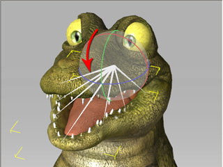

    1. Switch to the Rotate Object button.
    2. Rotate the jaw bone to the desired limit according to the position on the thumbnail image.
    3. If you want to dramatize the jaw open effect, then use the Move Object tool to lower the jaw bone more.

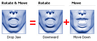

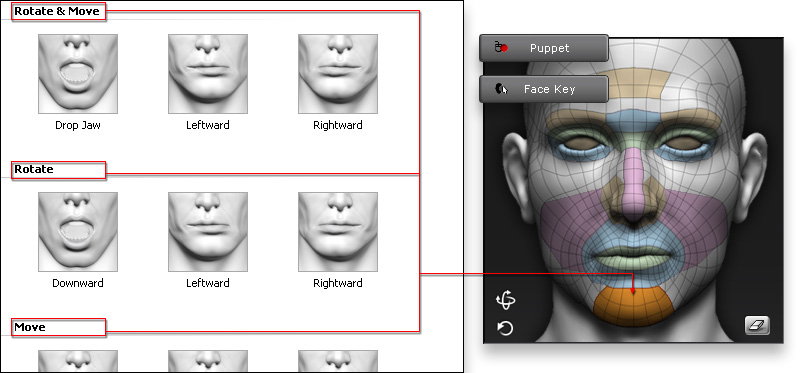

      • The thumbnail in the Rotate & Move section controls the position and the angle of the jaw bone. Its data equals to the combination of data from the thumbnails in the Rotate and the Move sections.
      • If you are setting one of the thumbnails in the Rotate or Move sections, then you may press the "Alt + Shift + \" key to preview the combination result of rotating and moving for the jaw.

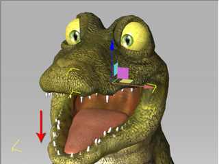

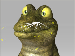

        Setting the thumbnail in the Move section to lower the jaw.
        Press the "Alt + Shift + \" key to temporarily preview the moving and rotating result for the jaw bone.

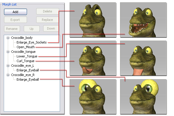

    1. Make sure that you have prepared and loaded the blend shapes for the character's face into the Morph List.
    2. After step 3 shown above, one of the thumbnails for the jaw setting is selected.

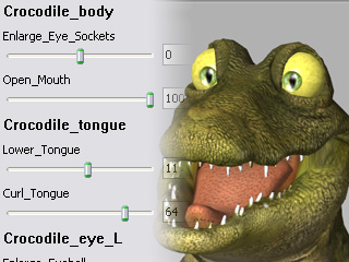

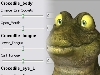

    3. Adjust the blend shape strength values by dragging the sliders on the right side of the Expression Editor. In this case, the expression that the jaw is opening with curling tongue is desired.

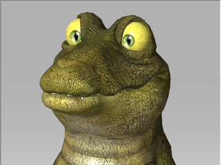

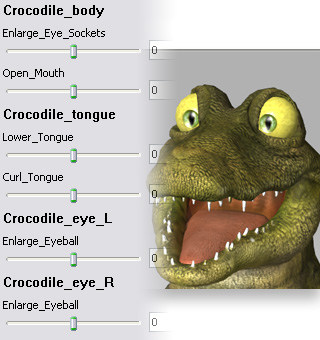

      Initial expression for the morph.

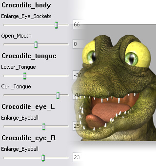

      The combination of different values of the blend shape sliders.

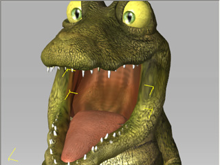

      Initial statuses for the morphing.
      The combination by different values of the morphing sliders.

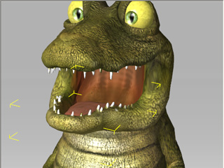

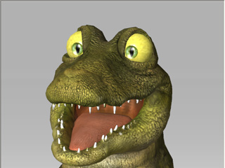

  8. After exporting the character to iClone its jaw can be animated via the Facial Puppeteering and Face Key panels.

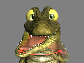

    Bone-morph-based jaw animation.
