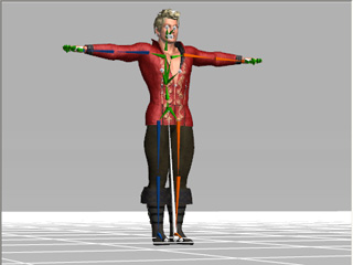

  1. Import a character (in this case, a DAZ character).

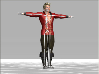

  2. Enter the Convert to Non-Standard mode and set the T-pose for the character.
  3. Pull down the Presets drop-down list found above the dummy pane. Select a preset from the list according to the 3D tool source of the loaded character.
  4. The bones will then be instantly mapped (Please note that if the selected preset does not match the bone structure of the character, then you will only get a partial-mapping or no mapping result).
