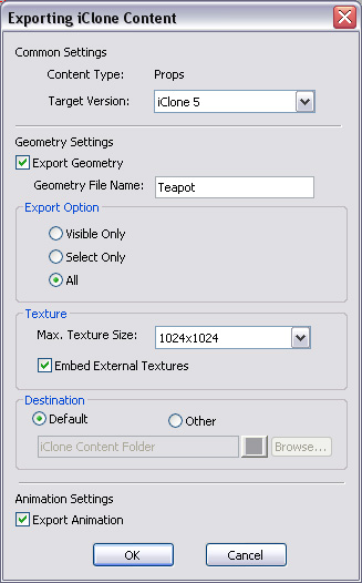

Select from the Target Version
drop-down list to determine the root folder of the custom folder where you want to export the model.
You may also manually change the destination folders (described
below) for storing the model or motions of the model.
Geometry Settings
In the Geometry File Name field, type in the file name.
Refer to the Export Options section for more information about how to set these options.
Refer to the Texture Settings section for more information about how to set these options.

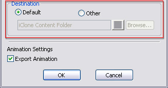

Destination Folder:
Select the Default radio button to convert the model into the
default custom folder:
Windows XP - C:\Documents and Settings\All Users\Documents\Reallusion\Custom\iClone 5 Custom\Props
Windows 7 or Above - C:\Users\Public\Documents\Reallusion\Custom\iClone 5 Custom\Prop\
Choose the Other radio button and click the
button to set the Custom Folder path to the
iClone Content Folder, by
default, in:
Choose the Other radio button and click the Browse... button to convert the model into your desired folder.
You may then create new folders in it to build your own custom props library.

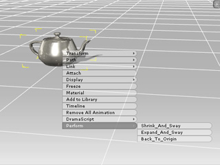

You may apply the animations in the Perform list of the prop in iClone.
Right-click on the prop to find its animations in the Perform list.
