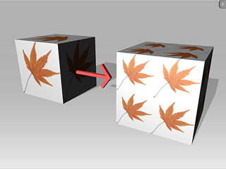

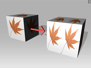

Lock Ratio
Enable the Lock Ratio box to simultaneously adjust the U and V values.
Lock Ratio: unchecked.
Adjust Tiling U from 1 to 2.
(Tiling V remains 1)
Lock Ratio: checked.
(Tiling V changes to 2 simultaneously)

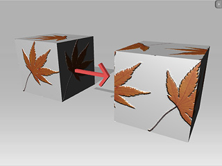

Affect All Channels
When this option is enabled, any change in the UV offset or tiling value will be applied to the other texture channels - Diffuse, Bump, Opacity, Specular, Glow. Only the reflection and blend maps will remain unchanged. Below We will take the Diffuse and Bump maps as example.
Current Channel: Diffuse.
Affect All Channels: unchecked.
Adjust Offset U from 0 to 0.5.
Only the Diffuse map moves.

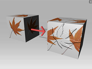

Affect All Channels: checked.
Adjust Tiling U from 0 to 0.5.
Bump map moves simultaneously.
