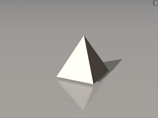

Apply a general prop in iClone.

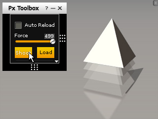

Windows 7: C:\Users\Public\Documents\Reallusion\Template\iClone 5 Template\iClone Template\Lua Script\

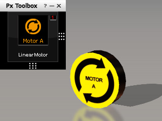

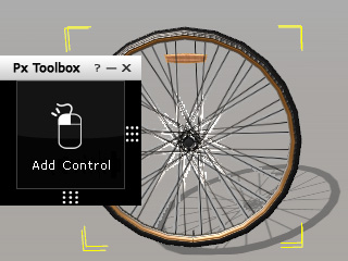

Drag and drop the *.iScript file onto the prop. It will be instantly given an empty control tile panel.
Double click on the empty tile to select a desired control.

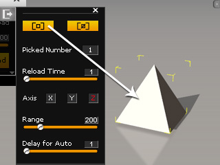

Open the Advanced Panel and pick the prop which the control tile will govern.

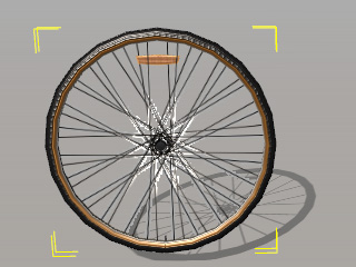

Close the Advanced Panel and you may then use the control to trigger the prop's animation.

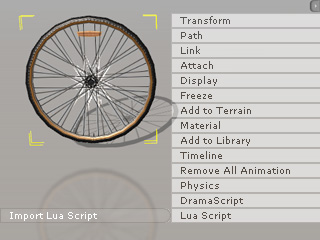

Apply a general prop from the Prop library.
Right click on the prop and select the Lua Script >> Import Lua Script command from the right-click
menu.
Load the saved lua script file saved in step 3.
