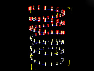

  1. Create any shapes for the object to follow.
  2. Select the path and click the Edit Path button to go into path editing mode.

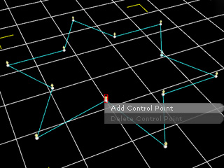

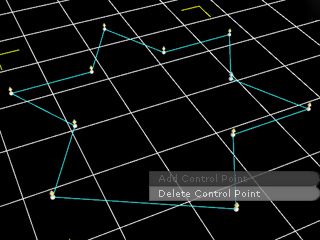

  3. Right-click on the path to Add or Delete Control Points.
    Add
    Delete

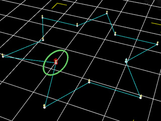

  4. Press the Ctrl key to select multiple points for deletion.
  5. Select
    Delete
  6. You can also use the Selection tool to select multilpe control points at once.

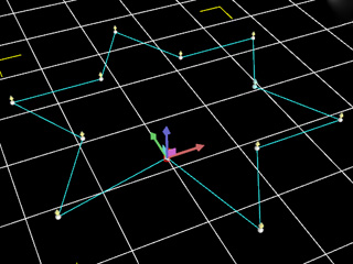

  7. While a control point is selected you can use the Move and Rotation tools to set its transform data.
  8. Move
    Rotate
