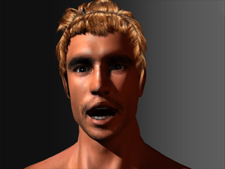

  2. Here is a typical result of fine-tuning a facial feature.
Before
After
Create any facial expressions from using the Puppeteering technique. Then fine-tune them with the Muscle function in the Face Key panel if necessary.
