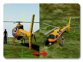

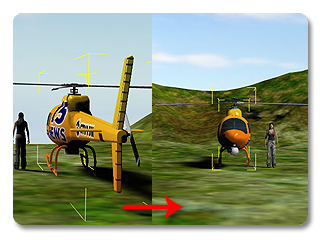

Press F to view the selected object (character, accessory, prop) face front .
Press Home to snap the camera to a 45 degrees perspective to the selected object (character, accessory, prop).
