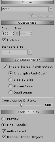

The export images area is split into 4 sections: Format, Output Size, 3D Stereo Vision and Render Quality. For 3D Stereo Vision related information, please refer to the Creating a 3D Stereo Project section.
Format
  1. Use the drop down list to choose BMP, JPG, TGA, GIF or PNG format.
  2. Click the Advance button to display the advanced options. Advanced options vary according to the output format you have selected.
JPG
Use the slider to adjust JPG quality.
TGA
Select 32 or 24 bit TGA output. 32 bit TGA images containing Alpha channels are more suitable for image and video composition.
GIF
Select the number of colors and transparency options for GIF output. When exporting GIF images with transparency, turning off the Anti-Aliased option will produce cleaner edges.
PNG
Select 32 or 24 bit PNG output. 32 bit PNG images containing Alpha channels are more suitable for image and video composition.
Output size
You can define the size of the exported image in the Output Size field. To define output size:
Select either a Standard Size or define a Custom Size using the spinner arrows.
Please note that if you activate the Lock Ratio box, you can only adjust the width of the project while the height is updated automatically in current ration.
Render quality
The render quality can be set to Preview or Final Render using the radio buttons. Check the Anti-Aliased checkbox to export an anti-aliased image. An anti-aliased output will produce an image with less jagged edges and pixelated areas. You may also enable the Render Hidden Objects option in case some objects were hidden during the editing process.
Click the Export button to export the image.
