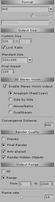

The export video area is split into 5 sections: Format, Output Size, 3D Stereo Vision, Render Quality and Output Range. For related 3D Stereo Vision information, please refer to the Creating a 3D Stereo Project section.
Format
Use the drop down list to choose AVI, RM, WMV, MP4 or Flash Movie format.
Click the Advance
button to display advanced options. Advanced options are only available when
you select MP4 for PC format or Flash Video.

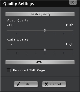

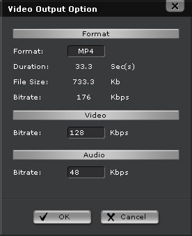

MP4 for PC settings |
Flash Video settings |
Output size
You can define the size of the exported image in the Output Size field. To define output size:
Select either a Standard Size or define a Custom Size using the spinner arrows.
Please note that if you activate the Lock Ratio box, you can only adjust the width of the project while the height is updated automatically in current ration.
Note: The HD media files of the AVI format can be selected in the Standard Size drop-down list. ![]() The flexibility of the output size depends on the video format you choose. WMV and MP4 have specific restriction on output size defined by the profiles. |
Render quality
The render quality can be set to Preview or Final Render using the radio buttons. Check the Anti-Aliased checkbox to export an anti-aliased image. An anti-aliased output will produce an image with less jagged edges and pixelated areas. You may also enable the Render Hidden Objects option in case some objects were hidden during the editing process.
Output range
You can either export the entire video, or a specific range of frames. Select the output range using the radio buttons in the Output Range field. You can also set the Frame Rate here using the slider. The output range can also be set using the 2 triangle markers below the play bar.
Click the Export button to export the video.
