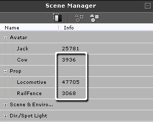

A project with 3D objects |
The face count for each minor object |

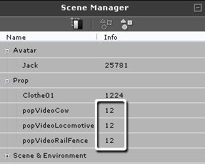

Convert all minor objects into popVideo and then load them back into your project to replace the original 3D objects. Doing this will decrease the project size and reduce your system-resource loading.
3D objects replaced with popVideos |
The face count for each popVideo |
