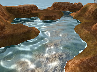

The wave of the water utilizes the Normal mapping technique so that the face count of the water remains minimum while the waves can still be extremely realistic.
Change the Wave

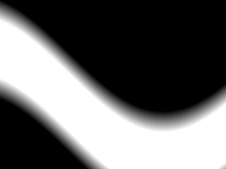

  1. Please click the Launch button to start your favorite image editor to paint on the image. Remember to save the image after editing.
  1. Click the Update button in iClone to see the result.
Note:
  • You do not have to worry if you paint a color or a grayscale image because iClone automatically renders the image as a grayscale one.
  • You may alternatively click button to load an image to form the waves.

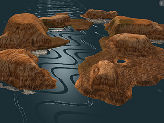

    Click the button to remove the wave style and click the button to save the style as an image file.

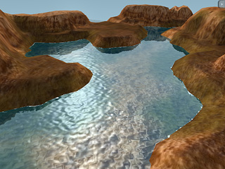

You may specify the density of the wave image in the water prop by setting the Size value. If you want to change the amplitude of the wave, adjust Strength.
Size = 5
Strength = 30

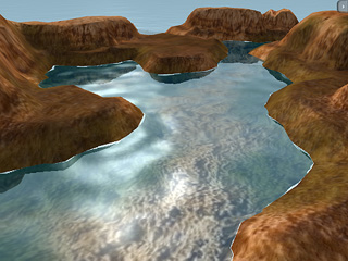

Size = 30
Strength = 30
