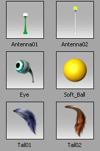

Please go to the Set/Props/Template/Props/Spring folder to choose any of the spring prop templates.
