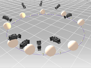

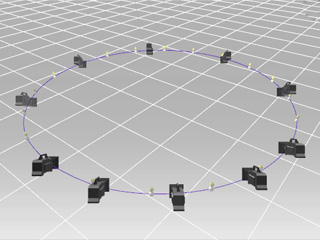

Create a path for the camera to move on.
Select the dummy and Pick Path to the path.
Since we have set the dummy as the parent of the camera, the dummy will move along the path with the camera.
You can now set the position keys for the Dummy on the path while also adjusting the Camera's rotation and position.
Camera to Path |
Camera to Dummy |

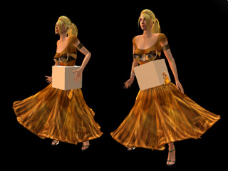

Attaching a group of props to a dummy parent and moving them as a group can save you a lot of time since you won't have to adjust each props' opacity.
Set a prop as the dummy.
Add a few props (in our example the skirt part) to the scene and position them to the dummy.
Select the prop and attach each piece to the dummy.
After making a group of items you may select the dummy and link it to the character.
Now the dummy with the attached objects will move with the character.
