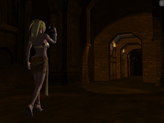

If you want to create a light, such as a flashlight, that is being held by an actor, you do not have to adjust the transform data key after key as the actor moves away. All you need to do is link the spotlight to the flashlight in the actor's hand.

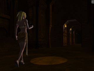

  6. Move the parent of the Spotlight to view the result.
